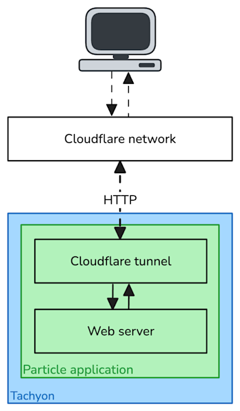

A powerful single-board computer with 5G out of the box can enable a bunch of useful remote monitoring projects. But, with your sensors wired up and your code running, you’ll need a way to interact with the device while it’s deployed. How about with a publicly available website hosted by the device itself?
In this post, we’ll walk through how to set up a Cloudflare tunnel into your Tachyon. This will serve a webpage to anyone who visits the URL.
In this example, we’ve got a camera connected to the Tachyon that’s running a Flask server. A user could then log in to the webpage served by Flask and monitor the live camera feed. Flockr uses this configuration, so let’s walk through how we’ve set it up.

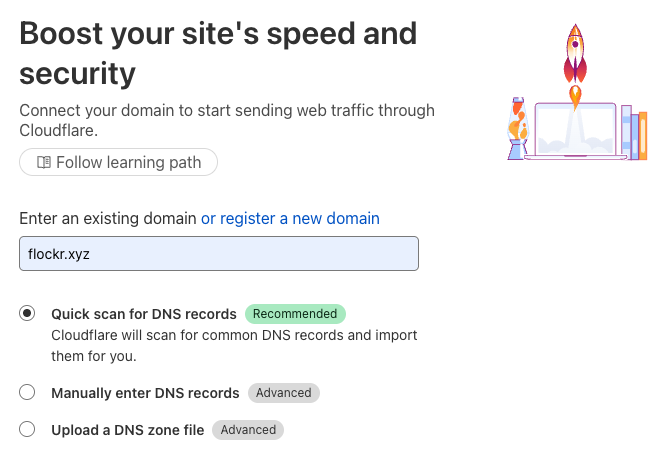

From “Account Home,” add your domain.

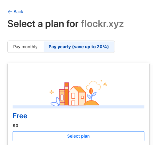

Luckily, this configuration will fall under Cloudflare’s free tier usage limits.

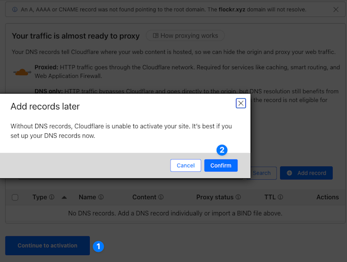

Next, on the “Review your DNS records” step, keep the defaults. Scroll to the bottom, and choose “Continue to activation,” Choose “confirm” in the “Add records later” modal.

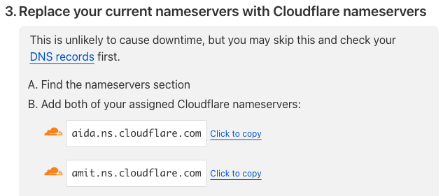

On the following page, scroll to step three: “Add Cloudflare’s nameservers” and make note of the two assigned Cloudflare nameservers.
center

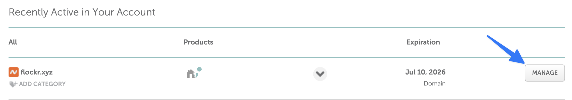

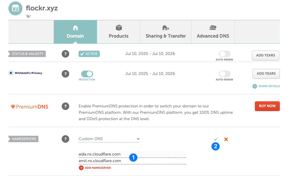

Head back to Namecheap (or your chosen domain provider) to edit to your domain’s configuration. Update the domain’s nameservers with the values provided by Cloudflare in the previous step.

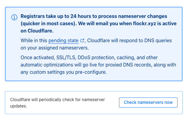

Once complete, go back to your Cloudflare console and choose “Continue,” You’ll be notified that it may take up to 24 hours to process these changes. We’ve found that it typically takes much less time.

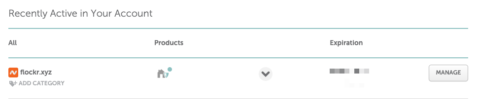

Once it completes, you’ll receive an email notifying you that the nameservers have been successfully updated.

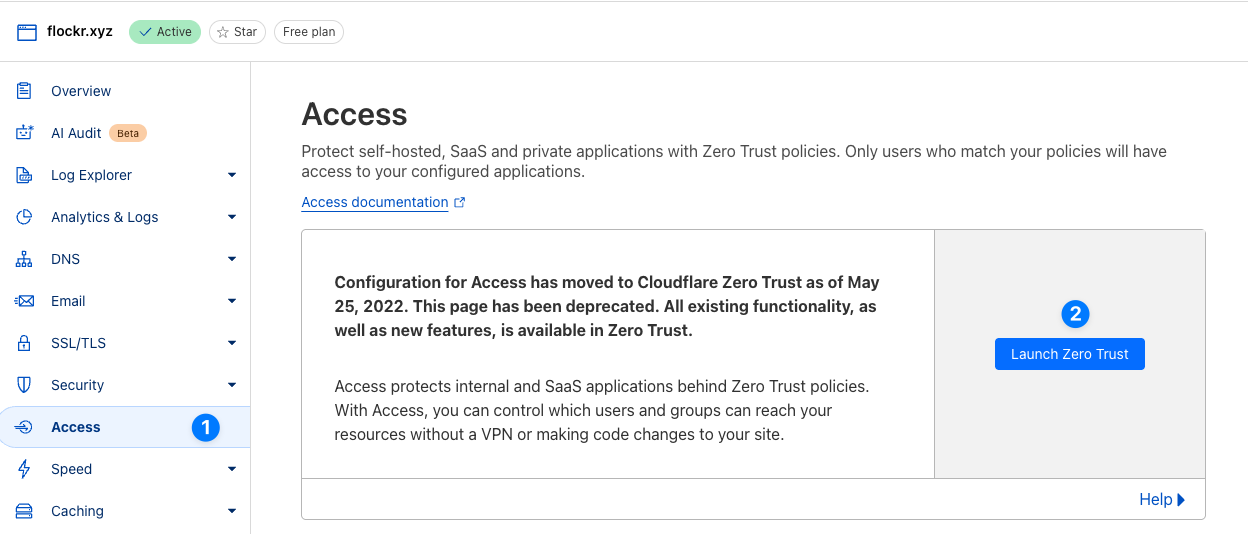

Once the domain has been properly configured, we can move on to setting up the tunnel that will route traffic to the Particle application serving the webpage. In Cloudflare, navigate to Access > Launch Zero Trust.

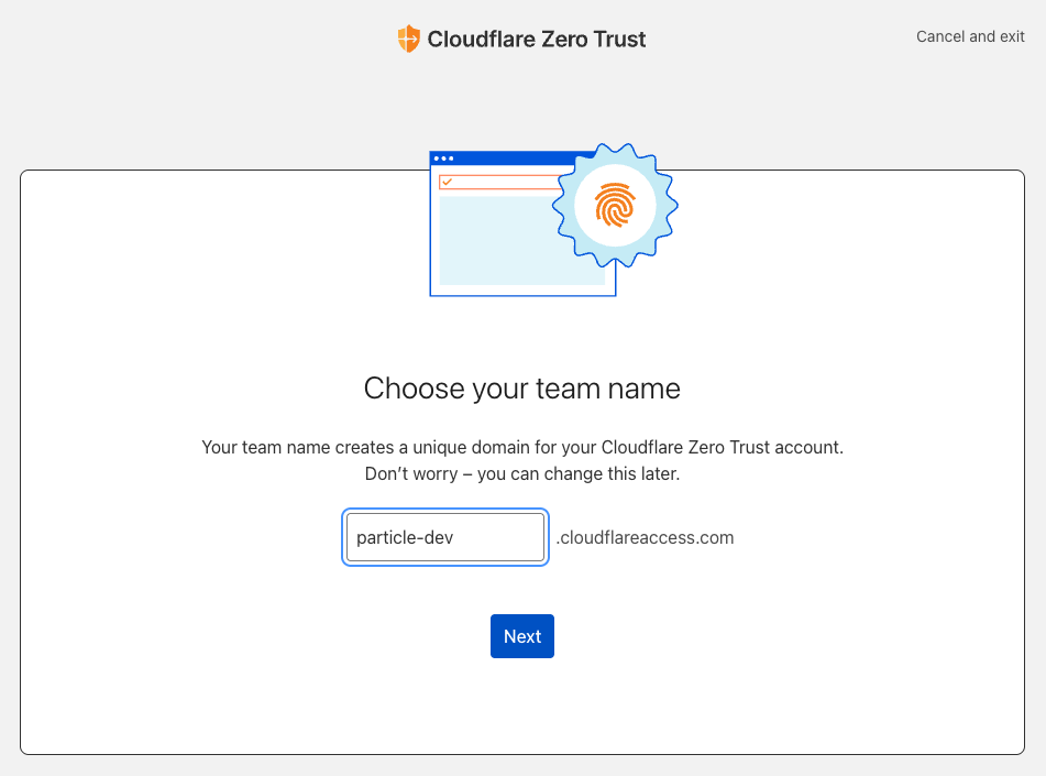

If this is your first time in the Zero Trust portal, choose a team name for your account.
center
The free tier will be plenty for this tutorial, but you may need to add your credit card information.

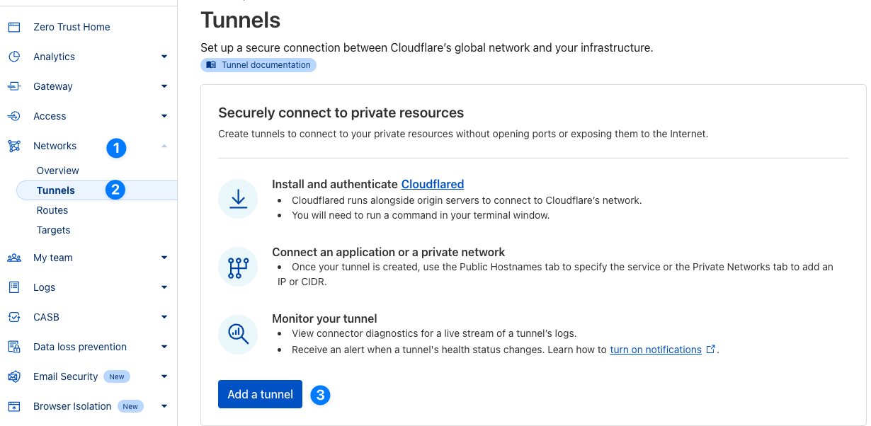

Navigate to Networks > Tunnels and choose “Add a tunnel.”

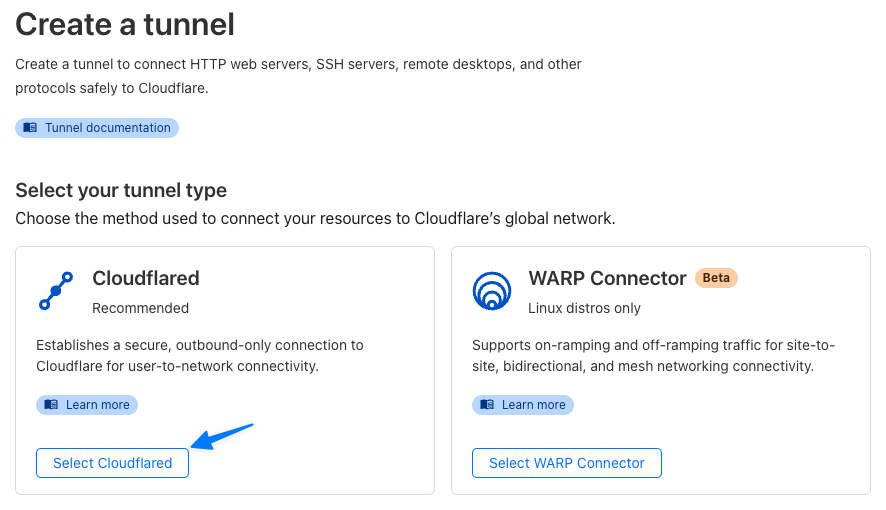

Choose “Cloudflared” for the tunnel type:

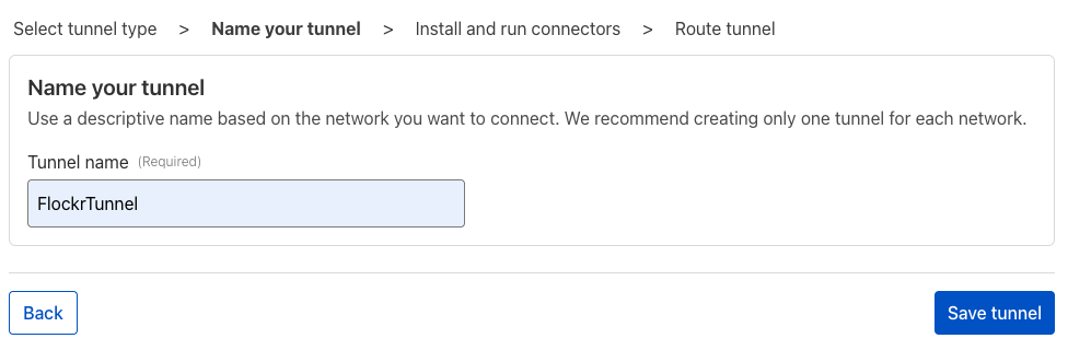

Give your tunnel a name and save it:

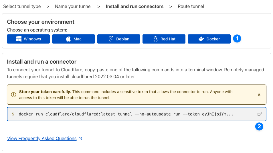

In “Choose your environment type,” select the Docker option and copy the run command. We’ll use this to add another service to our Particle application running on the Tachyon.

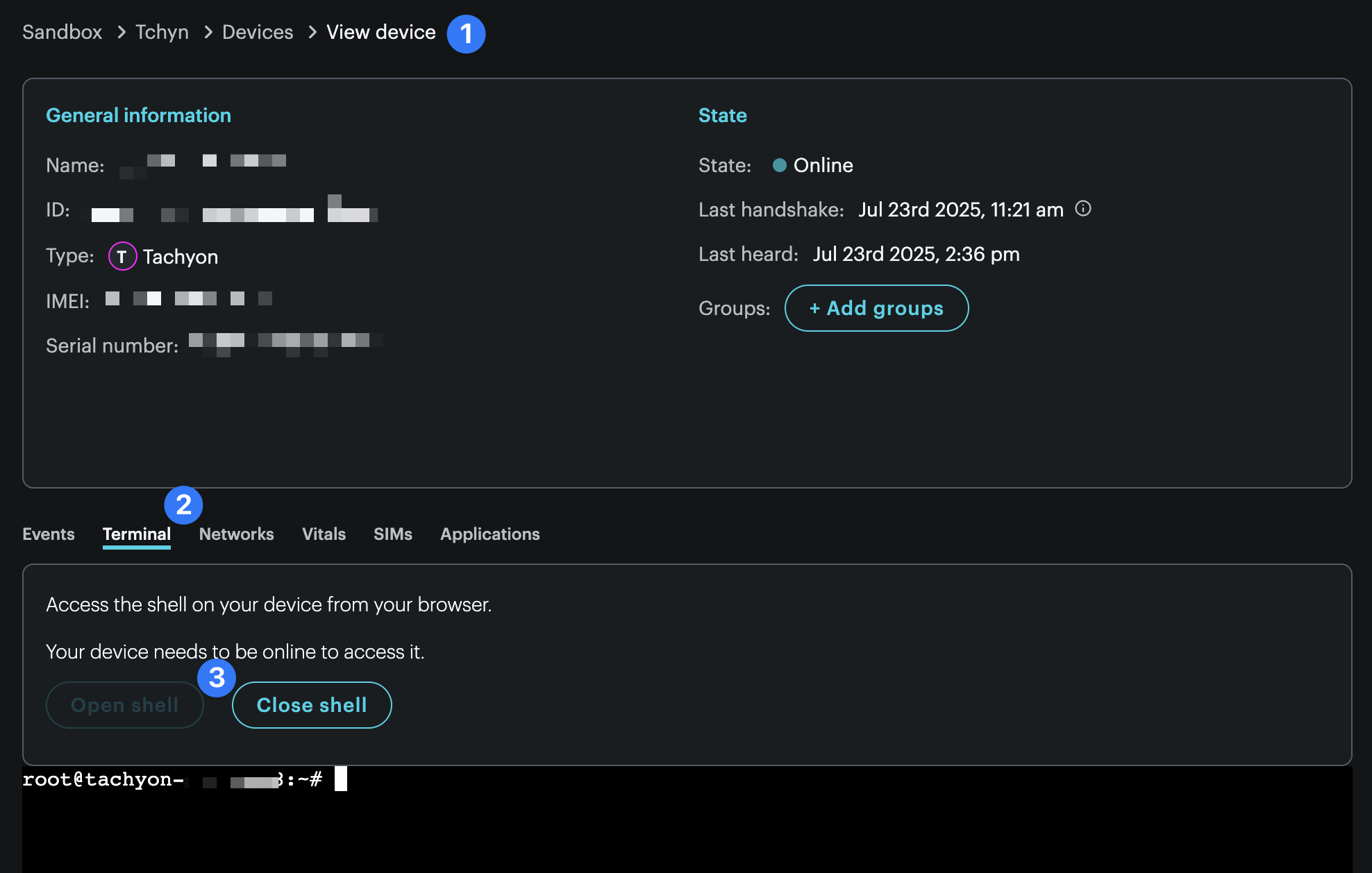

The following steps will assume you’ve already got a Tachyon set up and running. Once your Tachyon is online, navigate to the Particle Console’s device details view and select the terminal tab. Open a new shell into your Tachyon.
center
Switch the active user to the profile you configured during set up and navigate to the home directory. In this case, we’re using the default particle

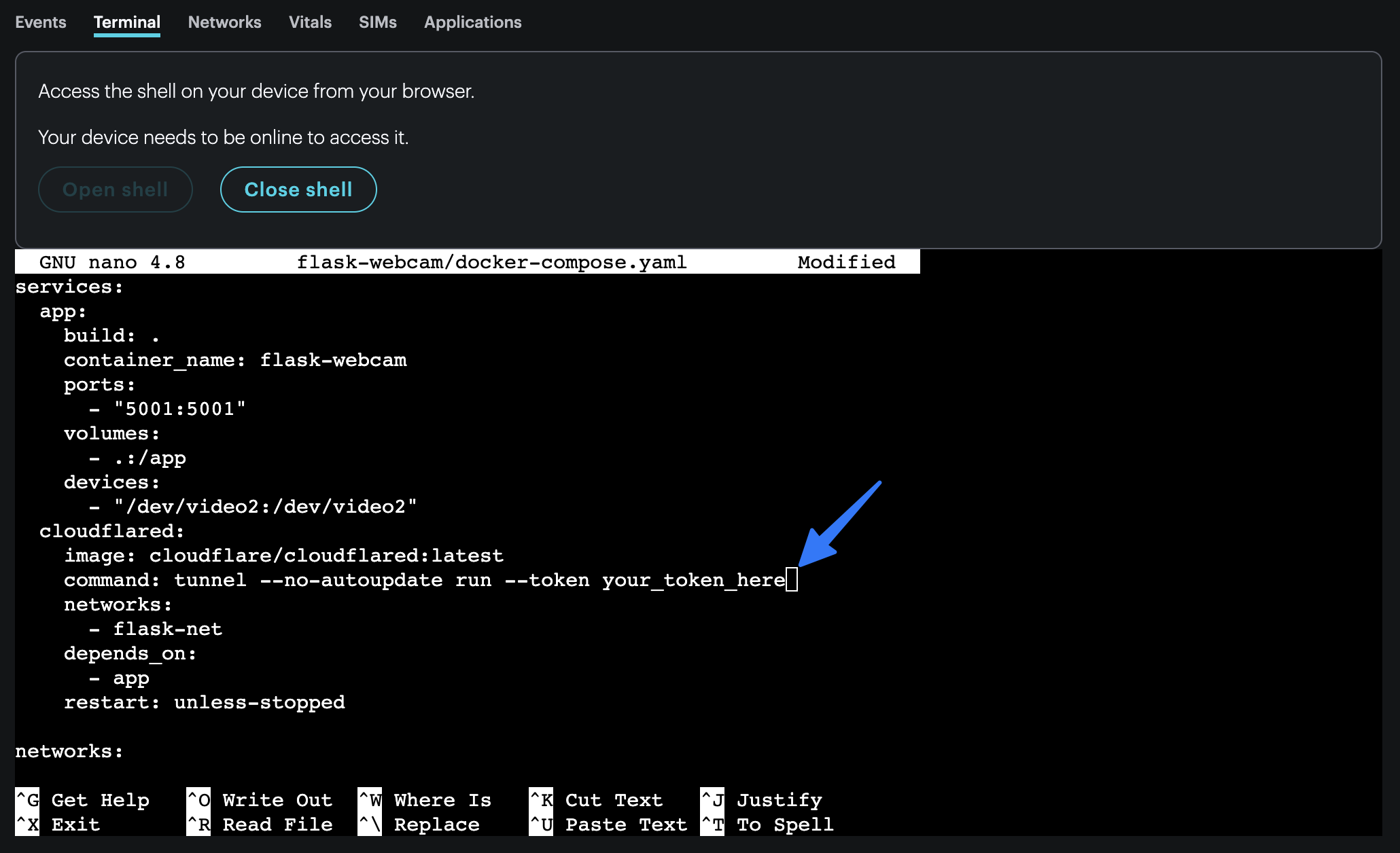

Now, we’ll need to add the Cloudflare token from the previous step to our project’s docker-compose.yaml
file.
To update your Cloudflare device token, run:
cd particle-flask-webcam nano flask-webcam/docker-compose.yaml
Find the line under the cloudflared
service that contains the command
. Replace the text after --token
with the token provided in the “Route tunnel” step back in the Cloudflare configuration.
center
To save your changes and exit nano type: ctrl + o
and ctrl + x

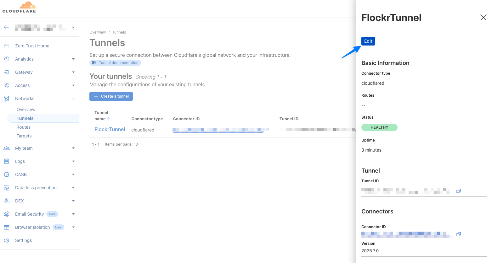

Head back to the Cloudflare console and navigate to the tunnel you configured before: Zero Trust > Networks > Tunnels > YourTunnelName. Select the tunnel and click “Edit.”

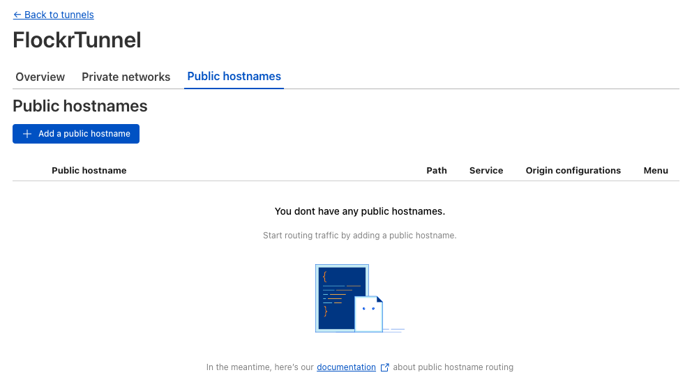

Navigate to the “Public hostnames” section of your tunnel’s configuration page. Choose “+ Add a public hostname.”

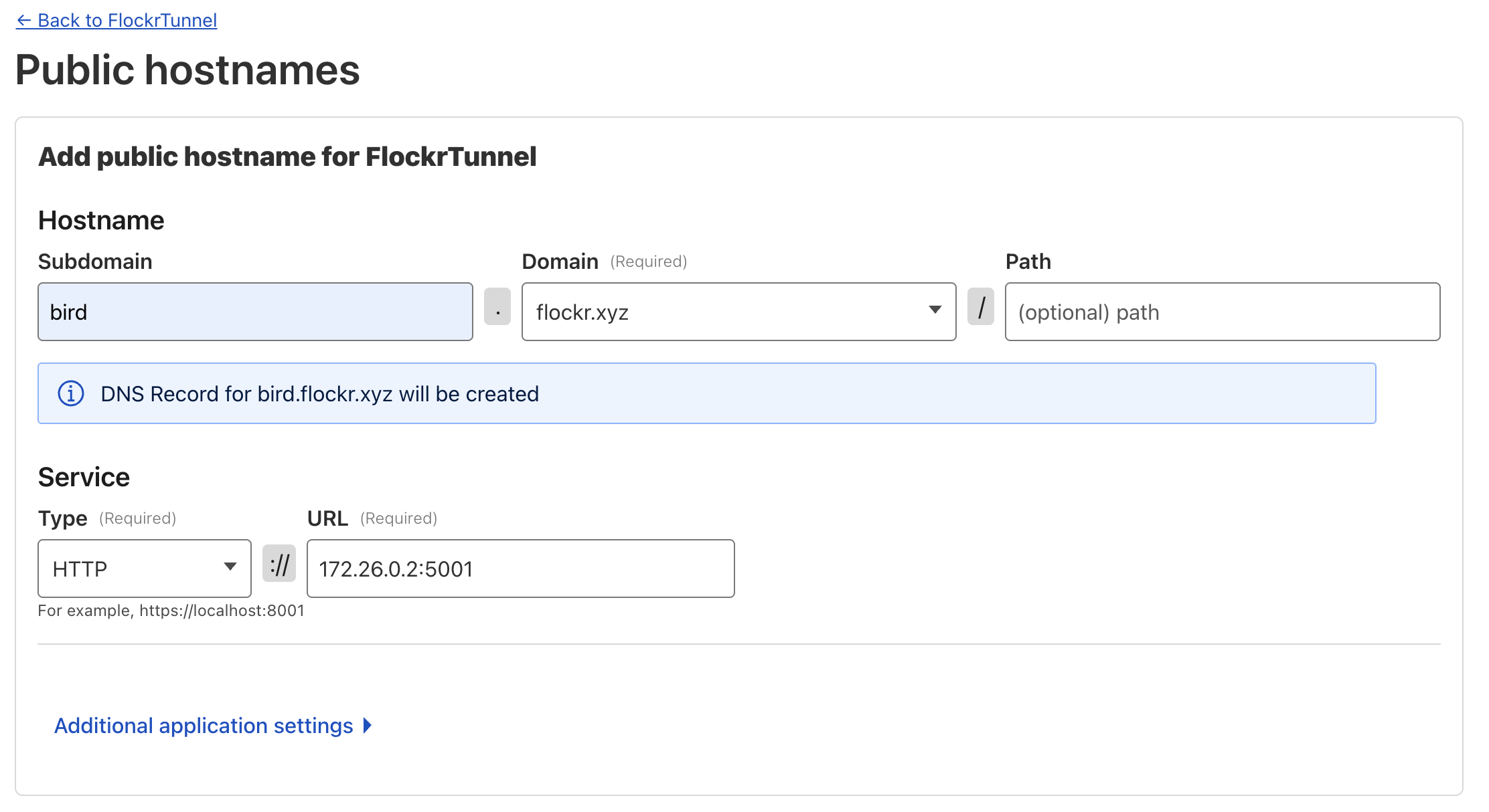

Fill in your hostname details. You can choose any subdomain, but make sure to select HTTP and provide the URL from the container’s output. This could easily be adapted to use HTTPS, however, you’ll need to modify the project to use a production grade Flask server such as guincorn.
center

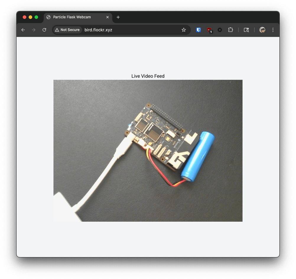

And that’s it! In this case, navigating to http://bird.flockr.xyz should pull up your Flask webpage with a video feed from the webcam.
Now we’ve got a live video feed of the server that’s hosting the webpage we’re visiting. How meta.
