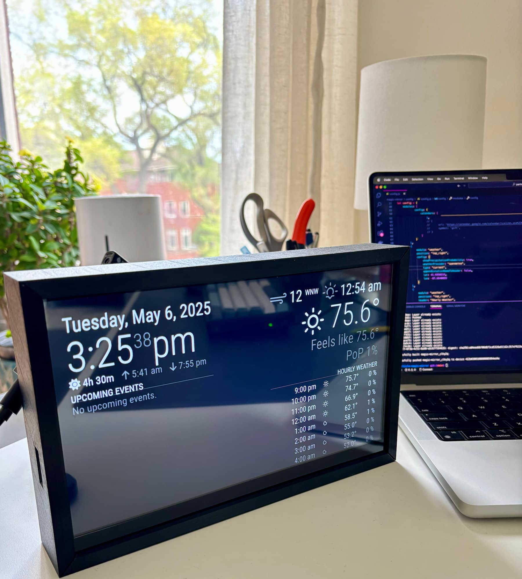

The MagicMirror² project is an open source modular dashboard. It provides an easy way to display widgets such as weather, calendar, news, and more on a wall-mounted screen. Let’s explore how we can use Particle for Linux to remotely manage our MagicMirror² deployment. For this tutorial, we’ll be using a Raspberry Pi 4B and a 10.1” LCD display, but the technique can be carried over to alternate hardware. You can view the CAD for the 3D-printed frame for the LCD display here.

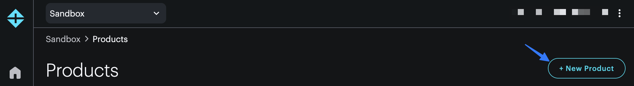

We should first set up a Linux product in your Particle Console. Log in to the console and create a new product. This product can exist either at the Sandbox level or organization level.
new-product
Give your product a name and description (optional), then select “Linux (Wi-Fi)” as the device type.

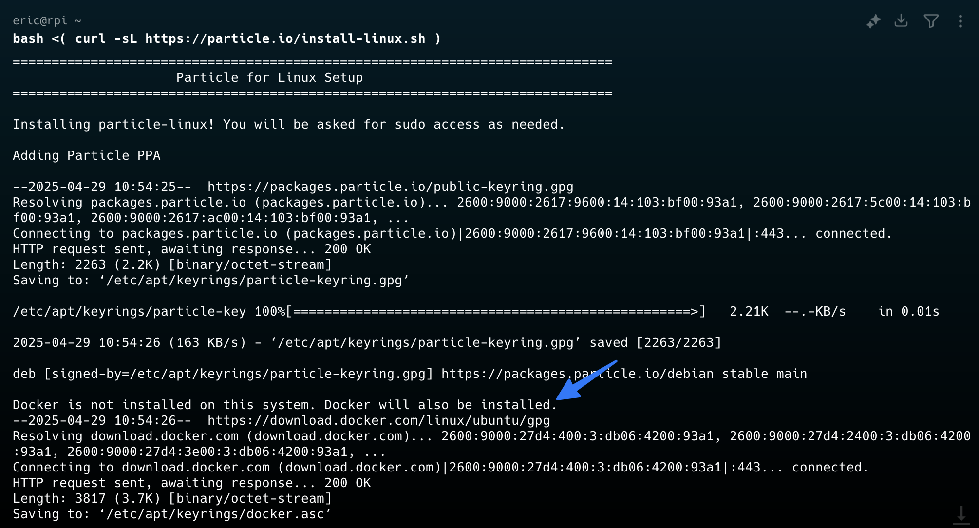

Next, we’ll need to install the Particle for Linux CLI on the Raspberry Pi. You can do this by running the following command on your device.
bash <( curl -sL https://particle.io/install-linux.sh )
Note that this script should be ran directly on the Raspberry Pi and not from an SSH session.
If you pay attention to the log output, you’ll notice that Docker gets installed (if not already installed) along with the Particle CLI. Docker is how the Particle subsystem manages the applications that are running on your Linux device.
particle-linux-install

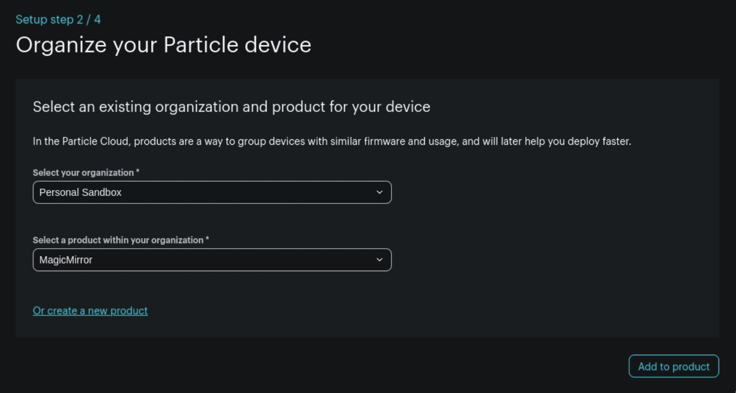

Once the setup script completes, you’ll be prompted to click a link that will link your Raspberry Pi with the Particle product you just created.
This should complete with output similar to what’s shown below. Follow the link from the Raspberry Pi to complete the onboarding process.
Starting interactive setup... To finish setting up your device with Particle, open the link below with your browser. You'll be prompted to log in to your Particle account or create one, and select a Particle product for your device. A product will help manage the device and keep things organized. https://setup.particle.io/linux?code=xxxx
In the web browser, you’ll be greeted with a few prompts that will require you to be logged into Particle. Log in, and click through the prompts making sure to select the Linux product you created in the previous step.
associate-to-product

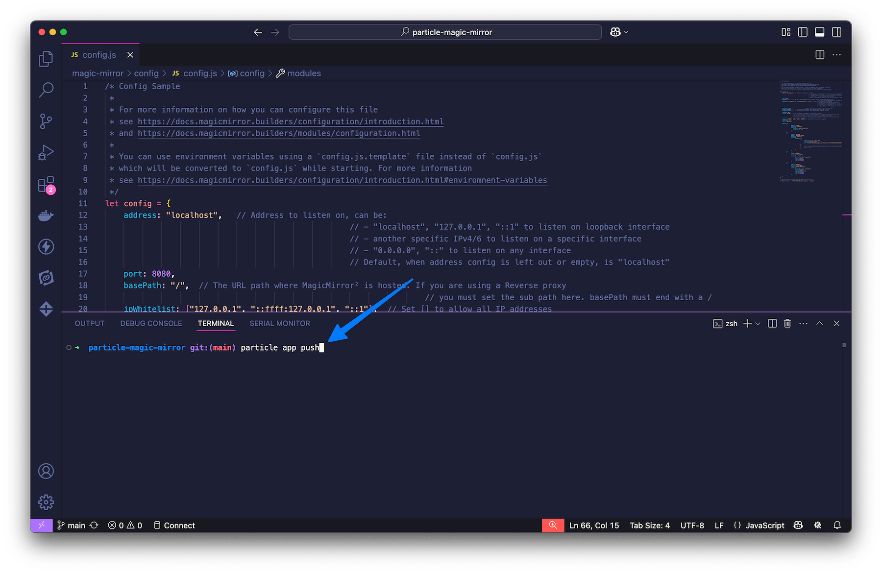

Open particle-magic-mirror/magic-mirror/config/config.js in a text editor of your choice and make any changes you’d like per the MagicMirror² documentation.
Once you’re happy with your changes, you can run the following command to push the app to your Raspberry Pi:
particle app push
The very first time you run this command, the CLI will ask some details about which device to target. Choose the organization (or sandbox) and product you created earlier.
You should then see the Particle MagicMirror² container start to build. Depending on your network connectivity and host computer you are using, this might take a while. Thankfully, it will only have to be done once.
app-push-screenshot (1)

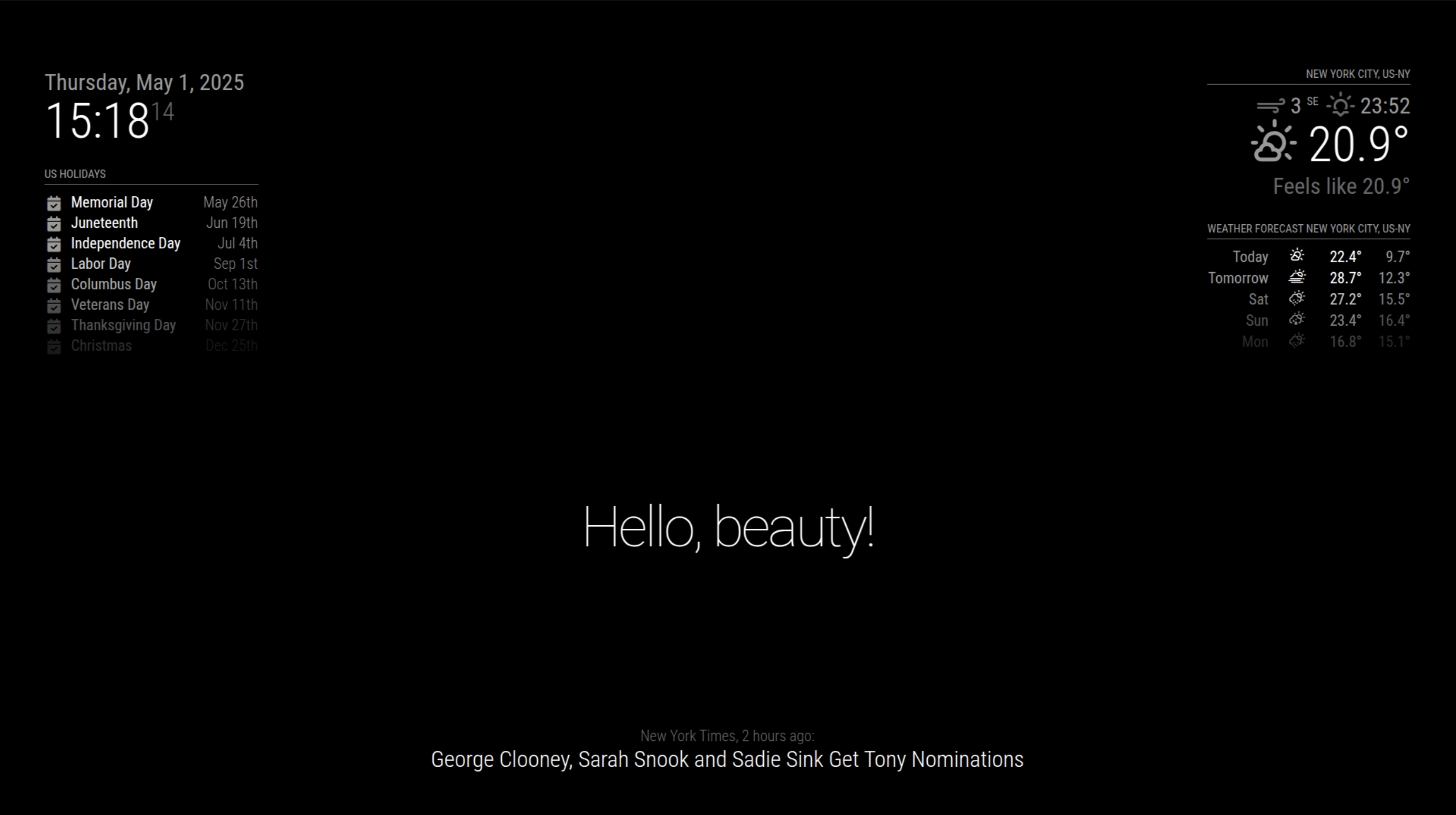

Once completed, you should see the sample configuration on displayed on your screen! Note that this might take a few minutes the very first time.
sample-config

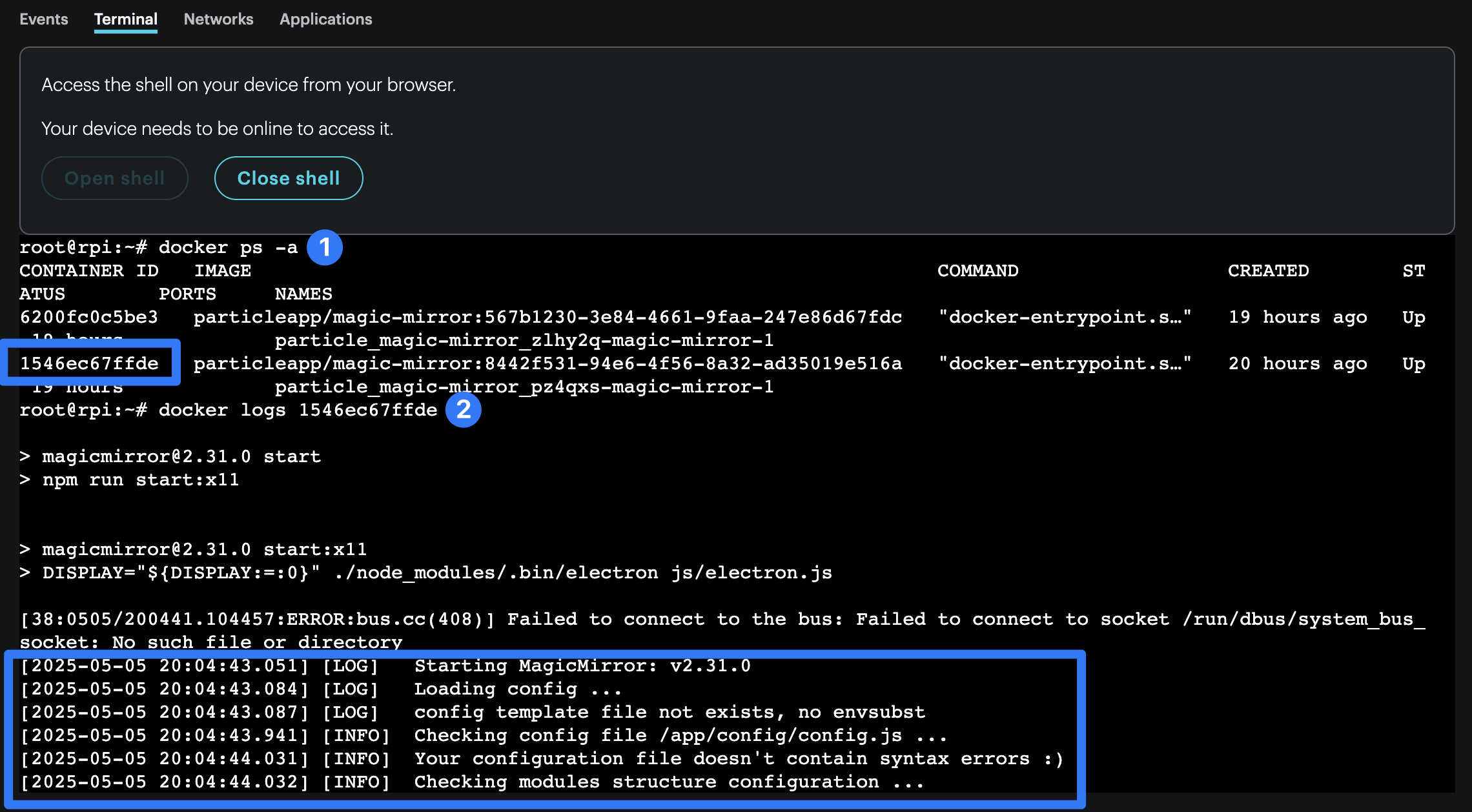

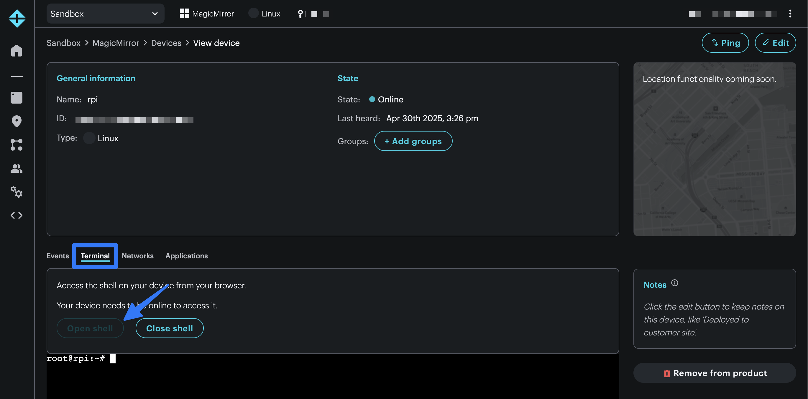

If you run into any issues, you can view the container’s logs using the Particle Console’s remote shell.
Go to Particle Console and open a new shell instance on your Raspberry Pi:
open-shell
Run the following command to list all containers:
docker ps -a
Then, copy the most recent container instance’s ID and run:
docker logs <container_id>
logs-example

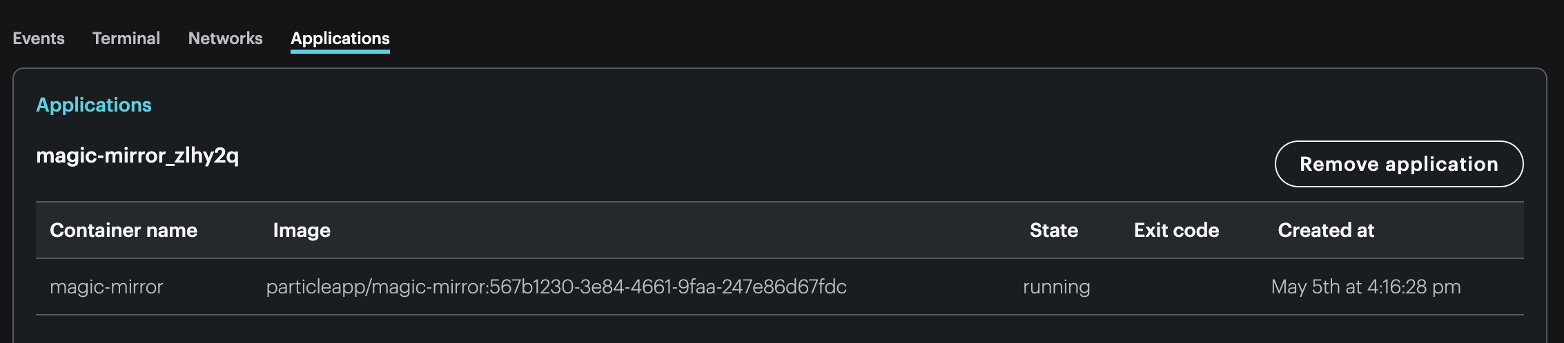

You can also view information about various applications that are running on your device in the “applications” tab of the Particle Console.
running-applications
